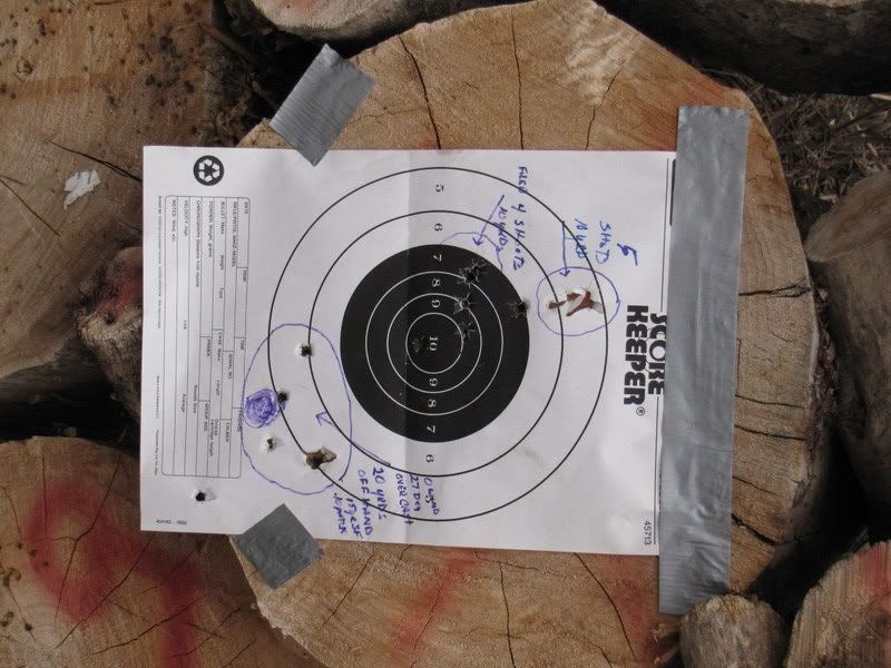

Ok so now as promised this weekend was the time for shooting . So I took the pistol out to check what she would do .
I was very impressed . Now mind you im not a pistol shooter . Myself I normally do not compete in that area at all .
So when I first began sighting the pistol in I started at 10 yards .
Now mind you the past owner of this pistol was there . I showed him the pistol and his mouth dropped . But his reply was , she sure is pretty but I know for a fact she will not shoot for beans .
Well said I . My bet is she will hold at least a 5 inch group maybe even 3 .
hIs bet was that it wouldn’t hold a 10 inch group .
So we put 5 bucks on the table .
Now I am proud to say that benched at 10 yards she held a 5 shot group that was all in one large hole .
So said I , do you want to pay me now or shell we move back ? But I don’t think that there would be any reason the group would grow to 10 inches even at at 15 -20 yards . It was agreed and I got me an extra 5 bucks lol .
But what I didn’t tell the past owner was that the group as about 6 inches higher then where I was aiming .
Considering this I got to looking as to why and realized that the rear sight was near 3X as tall as the front site .
So after getting home I filed the rear sight down to just slightly higher then the front .
This morning I ran down to a friends place along the river where we shoot . We don’t have a bench so we shot off hand . I used the same target as yesterday so as to have all the same shots placed on the same paper .
This time my sight picture was holding center of the bull .
This photo shows all the shots I have done .
But I have marked the 6 shots off hand at 10 yards . I had 2 fliers , 1 in the bull and 1 high of the group .
Notice this group only has 3 holes . But if you look closely you will see that the hole on the left is a double hole .
I then drew a new bulls eye and we moved back to 20 yards . Off hand
Again you will notice a double shot in the same hole in the group and one shot that flew low .
The temp out side is 30 deg .
Again im not a pistol shooter and I believe these groups would be ½ the size if it were not for me and my shaking .
But considering this barrel has a VERY slow twist , less then a ¼ inch in 6 inches , I would say that this is pretty good .
So the load for this was 15 grains of 3F . A .010 patch , “..015 may be tighter” .433 rb
So i guess that’s about it . All that’s left is to box her up and get her in the mail to Roaring bull tomorrow afternoon
